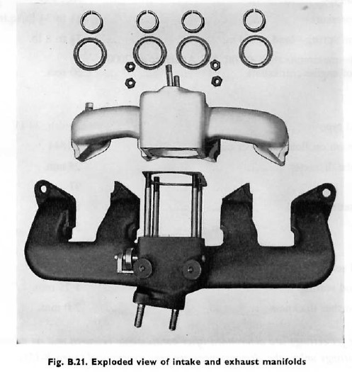

The book I'm looking at (Service Training Manual for Engine and Clutch Bedford CA Mark 2) says for the petrol engine:
"The intake and exhaust manifolds are attached together at the centre by studs and nuts, and a gasket seals the joint. Circular collars to which gaskets are fitted, locate the intake manifold ports with those of the cylinder head. The exhaust manifold makes direct contact with the head."
That seems to contradict itself, to me. (ETA makes a bit more sense now I've found the photo).
Later in, in the disassembly section, it says "Remove the nuts securing the intake and exhaust manifolds together, separate the manifolds and detach the gasket."
Is this picture any help?

Mike, many thanks for the "no" exhaust /manifold gasket conformation.
Ray, the problem I'll have introducing a gasket is that it will shift the inlet manifold away from the head, I'll just have to make sure that all the mating surfaces are clean and flat, an apply a smear of high temperature sealant.
