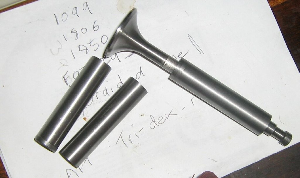

PostPosted: Mon Aug 19, 2024 10:55 am    Post subject: Guides Reply with quote
I am not a trained machinist, I usually mess up this type of job !
I made these valve guides for the Morris 25 engine on my little lathe. The correct grade and diam. of cast iron was found and it was cut down into short blanks. The O.D. of the worn out original guides is a unusual dimension: .531" The valve stems are 3/8" Actually, the new valves I have measure up as being .3735".
The blank or stock was held in a 4 jaw chuck and adjusted for nil runout . I used a undersized 2 flute milling cutter held in the tailstock and began the boring process from each end of the blank. Jobber or twist Drills are not ideal for this type of work, they tend to wander around if they are not exactly on centre. I find that the the short milling cutters are stout and they will remain within dimensional tolerance
After boring each end to a undersize , I then ran a undersized drill down the blank . I then used a adjustable reamer which is aligned by the tailstock to bring the bore up to close to 3/8".
The guides sit tightly on the valve stems . To achieve concentricity, the valves themselves are held in a chuck and they are used as a mandrel, the guides are machined to their final O.D.
Hope this works out !
PostPosted: Mon Aug 19, 2024 11:17 am    Post subject: Reply with quote
I would suggest that you don't want the valves to be too tight or they will stick when the engine gets hot.

PostPosted: Mon Aug 19, 2024 1:16 pm    Post subject: yes Reply with quote
Yes, that is something that needs to be taken into account. I am aiming for around .002" stem clearance in the exhaust guides. The engine rebuilders of years past, they used to ream the guides to final size after the guides were fitted into the engine block.
PostPosted: Fri Aug 23, 2024 12:01 pm    Post subject: Re: yes Reply with quote
I had to ream the guides in my '26 Dodge Brothers engine...but not until I had learned the hard way; with the engine stumbling and running rough just after I had rebuilt it!
I expect the absence of guide seals in old engines would have been one reason why they used more oil.
