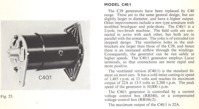

Without detailed part numbers such as 22250E/F and model C39PV for example it is impossible to compare. C40's are very rare and do not seem to be fitted to many vehicles. Physically they are 1/2" larger diameter.

PostPosted: Mon Nov 11, 2024 9:38 am    Post subject: Reply with quote
From a Lucas brochure

Thanks for that information Dave,
My vehicle has an RB106 control box fitted so it looks like a straight swap for the C40-L
