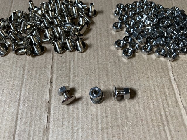

Here I have the complete new set of special screws and nuts required for assembling the side screens to their respective frames.
Unfortunately, the 3/16" BSF threads on the nuts and bolts are a disappointingly loose fit.
If I use these fixings, what would be the best way to unsure they stay done up.?
I have some thread locker...would that work with stainless steel (nuts) against chrome? or does it need heat to cure?

Thanks for your ideas. I tried PTFE tape but the threads seem too slippery for it although perhaps if I persevered with it I might get somewhere. Incidentally, you can get liquid PTFE so that might work better ...?
I know what my luck is like...if I try using glue it will somehow find it's way onto the screens!

The reason why the heads are oval shaped and have no slot in them is because they slide inside the chrome trim and the shape of the head turns and locks the screw in place as the nuts are tightened. Quite ingenious really!
I think once they are in place they will probably stay there. If I needed to remove any fixings it would doubtless mean I had made a mistake and ruined the job.

Thanks Dave. These things are so small and slippery I am having difficulty in holding them.! ( I have an issue with my fingers anyway) and as there are 62 screws - and a hole needs to be made in the material for each of them - I could do with something that I can use fairly easily.
I shall experiment with liquid PTFE and also see how I get on with a medium thread lock as you suggest.
