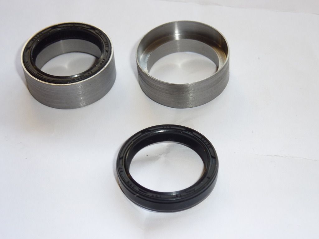

Can your friend not get a seal with the same ID and perhaps a smaller OD and turn a ring up so that the seal presses in nice and tight? Stateside Bearings in Kewdale have an impressive range.

I agree, its how I would get round the problem, seals are available off the shelf in any imperial or metric sizes, I put modern seals on a Morris 8 rear axle, originally the Morris axle never had seals, relied on an Archimedes screw to keep the oil in the diff.
