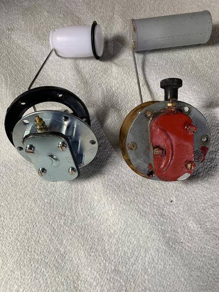

I would value the forum's advice on using a sealant that sets hard ...or one that does not harden.
What sealant should I use for preventing petrol leaks from the sender unit fitted to my MG TC slab tank.
The sender unit has leaked petrol with 1) a thick paper gasket soaked in Wellseal and b) more lately, a rubber gasket;
also coated in Wellseal...
I am thinking of using Tiger Seal on the vertical surface of the slab tank onto which the sender unit is secured. Any good?
There are six small screws threaded directly into the stainless steel of the tank. These MUST NOT be overtightened!
What do other restorers use?

alastairq wrote:
HAve you tried small non-metallic washers under the fixing screws?
No. The screws are not leaking (surprisingly) but the perimeter seal is. it is of a type I have not come across before;
it being made of rubber but not flat. it has deformed and I suspect it has been dissolved by the petrol.
I need to know if I should simply fit a solid flat rubber seal or go for one of the instant gaskets out of a tube.?

Silly question I know, but, are there enough screws to hold the top plate down?
Also, do the screws need wider washers [to exert pressure over a greater area?]
What sort of rubber is the gasket made of?
Is the tank 'surface' flat all the way across the hole?
Is there a missing metal 'washer' to go under the gasket?
Posts: 7589
PostPosted: Tue Jul 21, 2026 7:25 pm    Post subject: Reply with quote
The one on the left. Same number of screw holes as the old one. Flange made from the same metal.
The main difference is the gasket. I don't know what it is made from but the point is it has failed.
I am leaning towards a solid rubber gasket with Tiger seal. I have a selection of hole punches and will select the
smallest size I can get away with.
As it happens, I was considering adding more screws. It would mean drilling and tapping into the tank
but if that is what is needed then so be it.
Your question about how flat is the surface may well hold the key. This, as you will remember, is a brand new stainless steel tank. It has never been used. Further more it may never even have been tested.
Once I have removed the sender unit I will check out with a straight edge to see just how flat it really is.
What are the chances that there is a gap??

Don't choose any old rubber for the gasket. Petrol will make it go out of shape.
What type of rubber should I choose?
and where would I get it?
Posts: 2225
PostPosted: Tue Jul 21, 2026 10:56 pm    Post subject: Reply with quote
I think......nitrile rubber.
Unaffected by petrol.
Available in sheet form, even from Amazon!
Ebay,
if you have the time, then google where to buy nitrile rubber sheet in the UK?
Thus far, the thinnest nitrile rubber sheet I have spotted is 1mm.
https://deltarubber.co.uk/nitrile-rubber-sheet/
https://www.amazon.co.uk/nitrile-rubber-sheet/s?k=nitrile+rubber+sheet
https://www.ebay.co.uk/sch/i.html?_nkw=NITRILE+OIL+%26+FUEL+RESISTANT+RUBBER+SHEET+VAR.+SIZES+%26THICKNESS&_sacat=0&_from=R40&_trksid=m570.l1313
https://tym.co.uk/products/nitrile-rubber-sheet?srsltid=AfmBOoquwYG4t42SSm6Yn2JyC5PPtzg-dB5WF-AG7JKXqEc4amDfaCTu&variant=40422152503359
https://www.sealsdirect.co.uk/shop/category/solid-rubber-solid-nitrile-rubber-sheet-455?srsltid=AfmBOoqRo6BL9MMDaTOPgGEUu6OVEsFIM-TnzBWxSaopzYaPiYAjueIR
Just a selection from Google, above. [No AI]
