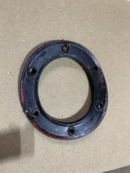

Just to sum up this 'drifted' thread...I have now fitted the correct cork gasket courtesy of our friends at the Morris Register. Filled with petrol and after several days still no sign of a leak.

PostPosted: Thu Aug 06, 2026 2:16 pm    Post subject: Reply with quote
ukdave2002 wrote:
Looks like a result Smile
I do think cork is more forgiving than "rubber" type of gasket in situations where the surface may not be perfect, possibly the way it deforms under pressure is superior?
The rubber gasket that I removed was badly deformed despite being evenly tightened to a good flat surface. I should imagine the type of rubber used was unsuitable; it also has a central 'void' which can't have helped.
In terms of design, perhaps a case of a little knowledge being a dangerous thing?. Confused
