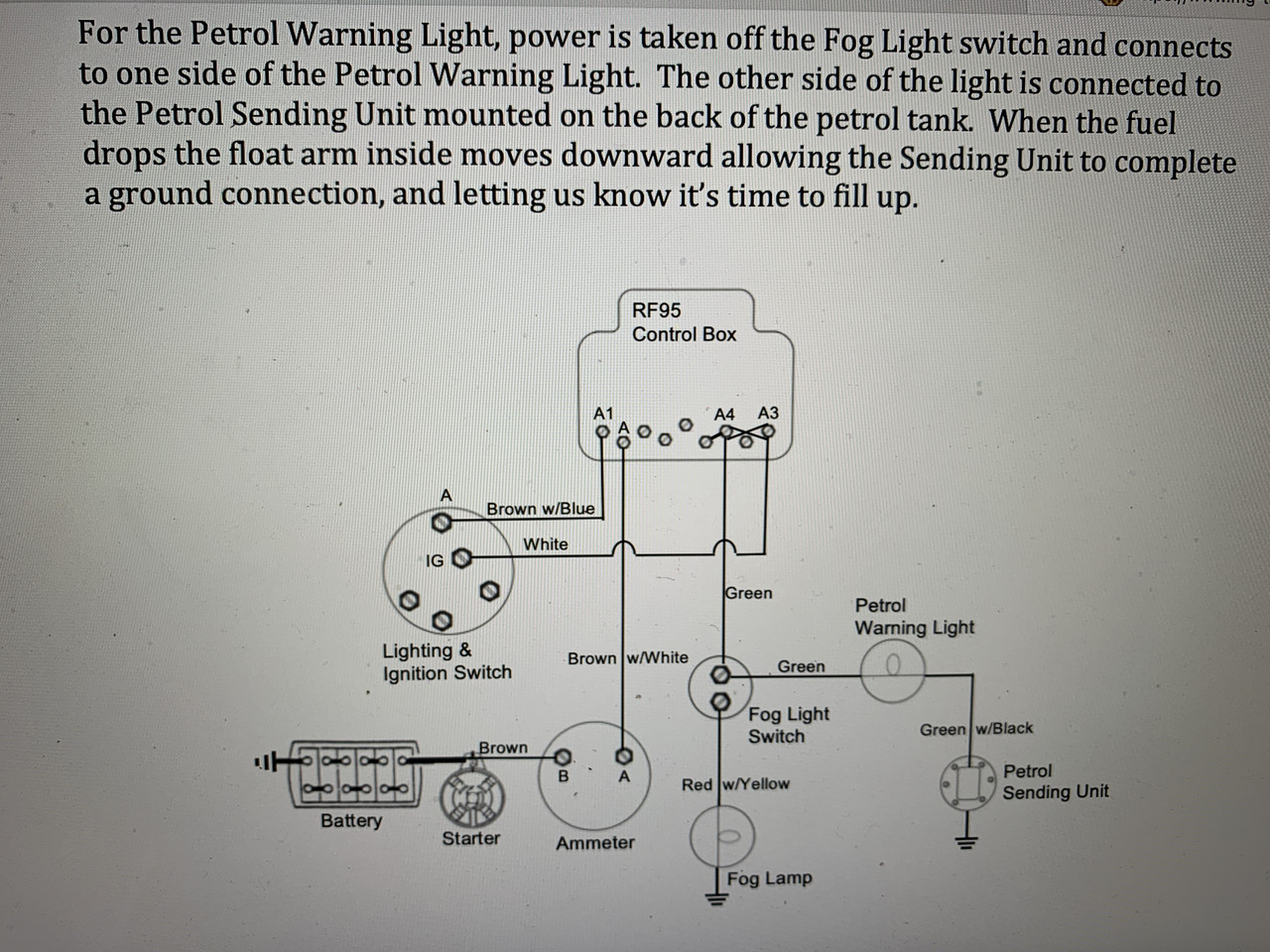

This is the wiring diagram that I have followed; if it helps.?
I can try to test for s/c but I am not really sure what to do. |

Ahh, so there is no -12v to the sender, the sender simply grounds the bulb, this is far more logical
Has any other part of the wiring been disturbed? I ask because the sender is a simple on off switch, it can really only have 2 faults it either goes open circuit in which case the lamp wont work at all or it goes short circuit so the lamp will be on all the time, but doesn't explain why the other bulbs dim when the tank is low?
Does the sender its self have a good earth, and with the warning lamp disconnected, the sender in the low fuel position is there a good earth on the "output" side of the sender? these could be checked very quickly with an ohmmeter. |

With the ignition switched on, I disconnected the top wire on the sender unit and to my surprise the light remained full on.
The light remained full on regardless of the float arm position... but this time there was no dimming of the other dashboard lights when put in the empty position; ie with the brass fingers making contact at the top.
Anyway. I think I have worked out where I have been going wrong. I have had to replace the warning light and amid all the frustration I have wired it up incorrectly. |

| Ray, all the sender does is provide an an earth to the warning lamp. If you have disconnected the sender, then, somehow the bulb is getting an earth from the loom, you mentioned that it was soaked in petrol, most looms especially modern ones are fairly petrol resistant, but clearly the lamp is getting an earth some how? |

Thank you Dave. You have de mystified the system for me. Now I realise the sender is acting like a switch simply to earth the dashboard light everything makes sense.
I had to replace the light and mistakenly wired it incorrectly.
