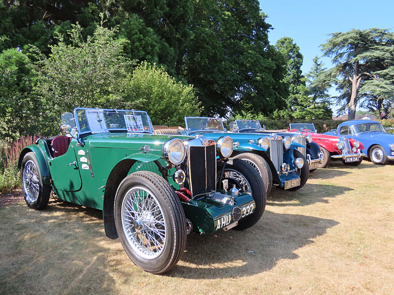

I'm a bit behind with keeping this section of the forum updated.
We bought this '34 PA earlier in the year following the departure of our '40s Dodge pickup. It was restored around 5-6 years ago I believe, I've not owned anything old and sporty for quite some time. Since restoration it has completed one or two continental trips which gave me some confidence in it (although the previous owner was based on the south coast, so handy for ferries etc).
So far we've had it to quite a few gatherings, it's certainly a full-on driving experience. The original PA engine has been replaced by a PB unit (slightly larger capacity), both are overhead cam crossflow engines and very revvy.
