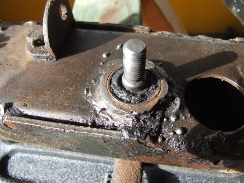

I wish to remove these bushes from the chassis, one side the bold is seized in, the other came out freely.
Do I need a press or extractor, another way I had thought of, well was suggested to me, was two sockets a piece of studding large washer and nuts.
One socket to fit outside of the flange that the bushes pass through, the other would be a close fit through the flange, a couple of spanners and screw/squeeze the bush out.
I have been told they need to be removed if I wish to have the chassis powder coated

It is easier to remove the rubber centre and centre saw cut the out tube. The bolt + 2 sockets method is the usual way to fit the new ones _________________ Rover P2

As Phil says, remove the rubber first, if you have a good blow torch use that to burn it out. _________________ ROVER

Have removed the bushes, ran a drill through the rubber, pushed out the inner, couple of taps and they dropped out. then hacksawed the outer and removed them that way.

Either drill a slot into them, and then colapse them in, before punching out, slot giving you some movement, or like already said burn them out. Lots of smoke though!

So I drilled tham and cut them out, simple when you think about it
