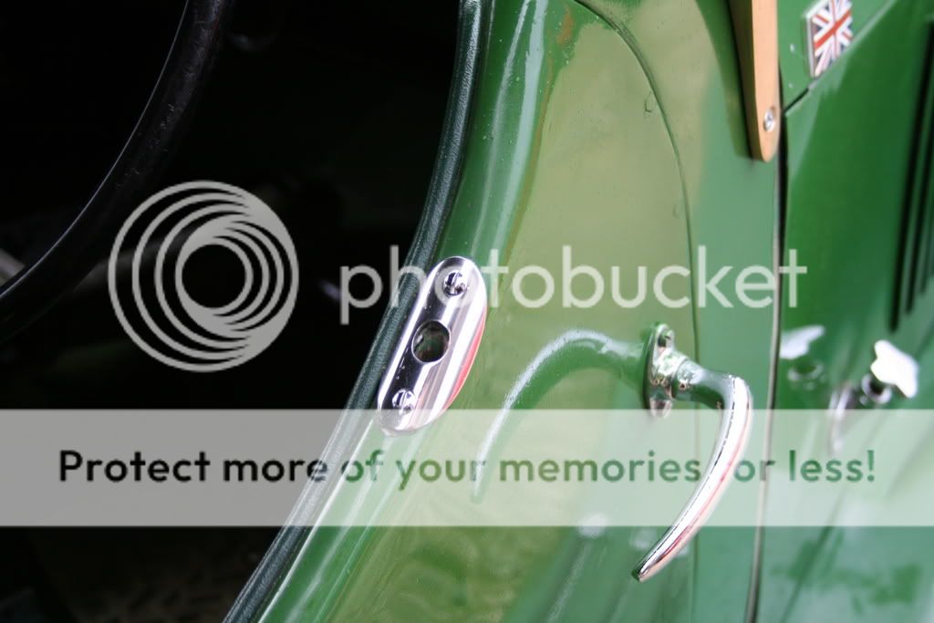

Here are a few pictures of my little Aero. She is pictured in the garage as I started removing parts of her from the off. I am changing the bolt on hubs to splined hubs and hence fitting new wire wheels, changing the Singer windscreen pillars to the correct ones which I have had cast and plated and restoring the rad shell and badge for starters.
Forgive any errorsbut this is my first time at adding pictures
With the wrong Singer screen
With the newly cast screen pillars prior to plating
Side screen sockets before replacement
Side screen sockets renewed with polished stainless steel shrouds
