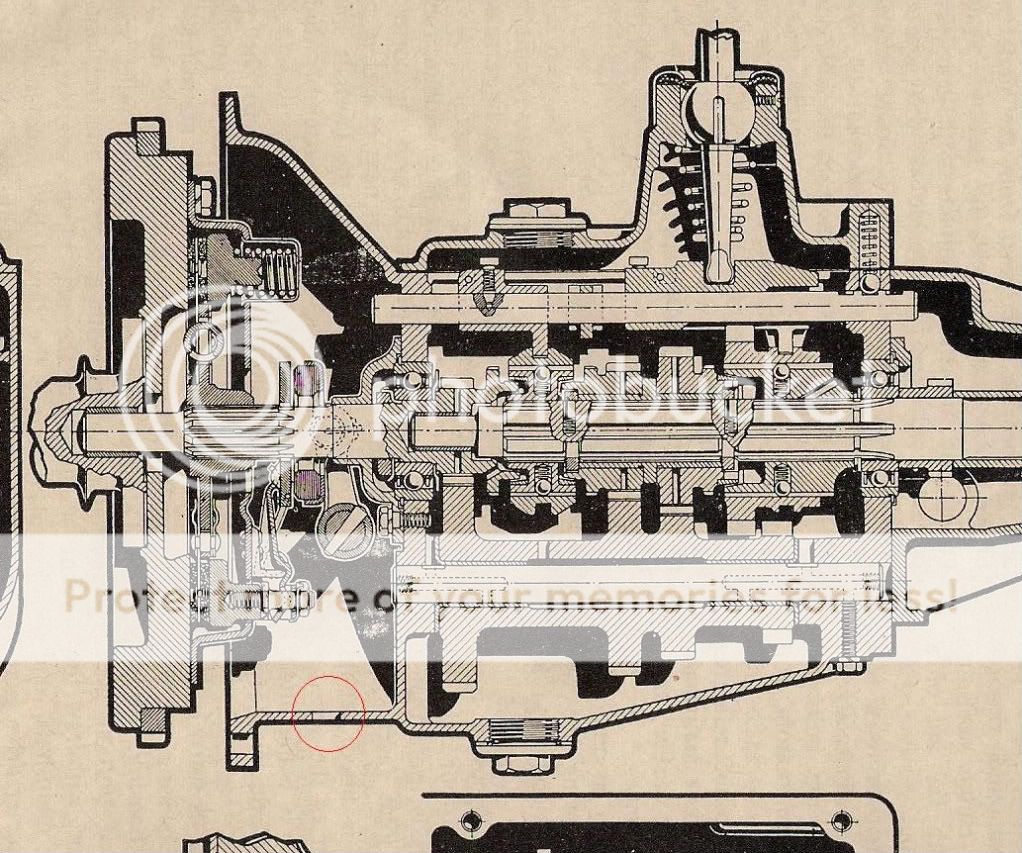

Ive added a picture to show where the oil is leaking from

yes that is the bell housing, and as been stated it will be either the rear main engine leaking or the gearbox if it is the box and it do's not normally need topping up it will be the engine you may also be able to tell if it's the eng if the oil is a little black in the sump and its the same colour dripping out then again it must be the eng.

If the cross section shown is of your gearbox, then it is quite cear that the "oil seal" is merely a "flinger ring". which rotates with the shaft
and "flings" off the oil like a catherine wheel.
Since the oil level should be well below the bearing and ring there should be no leak when stationary, nor when moving because of the flinger ring.
Are you sure you have not got too much oil in the gearbox to above the level of the level bung - or possibly the dipstick mark if fitted?
If over filling is not the problem, I'm afraid the problem is most likely engine oil. But then again over-filling the engine could cause the problem (among others).
That bottom bolt in the front flange (below the front bearing) also looks as if it might cause an oil leak if it has come loose because the bolt hole is not "blind" and goes right through the casing.
Jim.

I have rebuilt 3 of the series E box's, there are no seals (apart from a felt on on the rear, that was missing on all the box's I rebuilt!)
Jim is correct the box relies on machined scrolls to throw the oil back in the box, if the box is over filled there is a hole to feed the excess oil out in to the bell housing and out of the jiggle pin Smile hole.
I suspect its just overfilled, but if its more serious the good news is that the box is very simple to work on, somewhere on this forum I posted some pics on my SE box rebuild, I also added modern seals to the front and rear to aid the scrolls.
