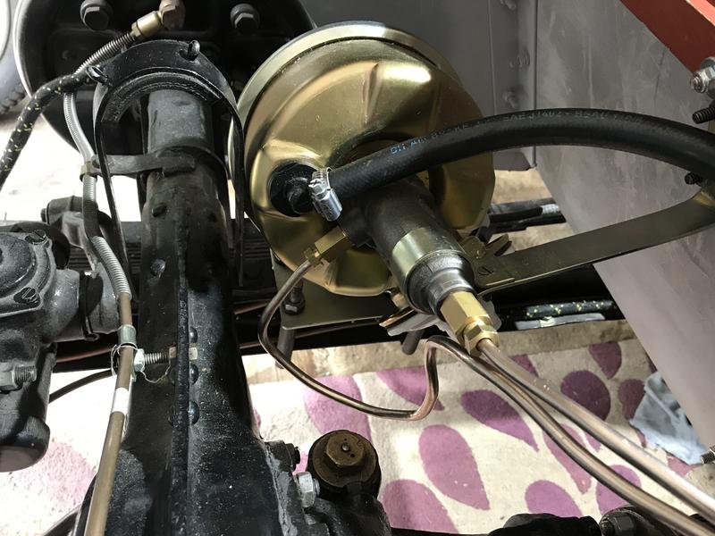

The question of the brakes not working is getting beyond my pay grade. The master cylinder and wheel cylinders are all new as is the pipework. The 1.9:1 servo is a genuine Lockheed unit (not one of the super cheapo Chinese copies that are flooding the market) and I have installed everything as best I know how using the correct hose.
If the engine stumbles badly when I apply the brakes, I assume the air being drawn from the servo is interfering with the mixture.???
I may be forced to add an electric vacuum pump; thus removing the engine from the equation.

Are there any valves in the servo air circuit that could either be faulty or fitted the wrong way round?
Posts: 7210
PostPosted: Sun Nov 09, 2025 10:19 am    Post subject: Reply with quote
Good question. The only valve in the system is the check valve that is attached to the servo unit. I have not added any other valves ...although I probably should do.
I would much prefer to use the engine vacuum if I can rather than fit an auxiliary one. I was advised by Steve Baker (s/c supplier) to take it from the supercharger end plate; that is after the carb and before the impellers. My friend and neighbour has suggested I try fitting a restrictor in the line.

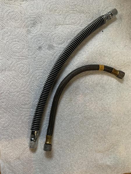

So... I received the hose but unfortunately it has metric threads... when what I needed was BSP. This is what happens when you try to save a few quid. The stainless steel braided hose was advertised as 1/8" which (being an imperial size) led me to assume it was 1/8" BSP. The diameter of the female couplings was the right size for BSP but it has metric threads so will not fit.
In the end I have bought the right part from Octagon Car Club spares...which is what I should have done in the first place.

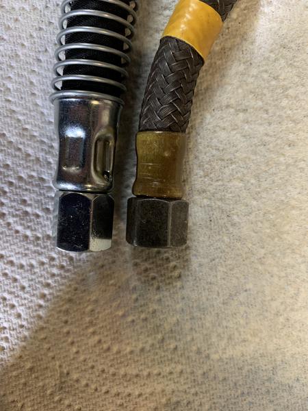

Just to add even more angst to this job, the new oil hose from Octagon - while the correct 1/8" BSP fitting - is a fraction too long for the union fitting. As can be seen the nuts (at both ends) on the replacement are longer and presumably will need to be pared back.
It is cold and wet and I am not in the right frame of mind for mucking about... so I have shut the garage door on it.
Posts: 7210
PostPosted: Sat Nov 15, 2025 6:26 pm    Post subject: Reply with quote
I have now ground down the nuts and fitted the hose. No more oil leaks, thank goodness!
I checked the servo by pressing the pedal and starting the car. If the servo was working correctly the pedal would have dropped an inch or so when the engine fired ... but there was hardly any movement at all. If I start the engine then depress the pedal it will immediately stall.

It looks like there is insufficient vacuum to operate the servo. Not only is this because I have a supercharger but I have discovered that my new sports camshaft has greater valve overlap which leaves less time for a vacuum to form.
I have decided to order a vacuum pump and do what I can to quieten it down. Ideally I would have chosen a 'vane' type over the 'piston' version because they are much quieter. (60% less).. but they all seem to be made in America and I need to keep things local. The vane pumps are also without exception described as 'plug and go' and 'vehicle specific'; this means if I cut off the pre wired plugs for my installation ...and there is a problem ... I will not be able to return the pump for a refund.
This video shows the set up of a simple vacuum pump - up as supplied by 'Car Builder Solutions' - so all I need to work out is how best to mount it in the car. I plan on fitting the pump in the enclosed area behind the seat; opposite the servo. I have also ordered a small K&N filter which should help reduce it's noise.

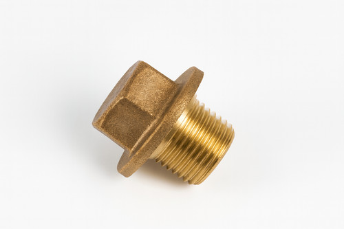

I need to remove the vacuum hose from the supercharger end plate and plug the holes.
To that end I have ordered some 1/8" BSP end plugs

Eventually I was able to pull the hose out and start thinking about where to cut it. Luckily the pump will sit neatly on the chassis rail on the opposite side to the servo. It's bracket is mounted on four rubber feet - 40mm apart - which means they can neatly straddle the chassis rail. The feet have 3/16" studs that need to be fixed to a firm surface.
To ensure a secure fitting I measured and drilled four holes in a piece of steel plate and attached the feet to the the pump and the plate with the supplied nuts but added spring washers for extra security.
To secure the assembly to the chassis rail without drilling holes in it, I will be fitting two 40mm x 110mm 'square' U bolts. I did this successfully with the servo (on the opposite chassis rail).
