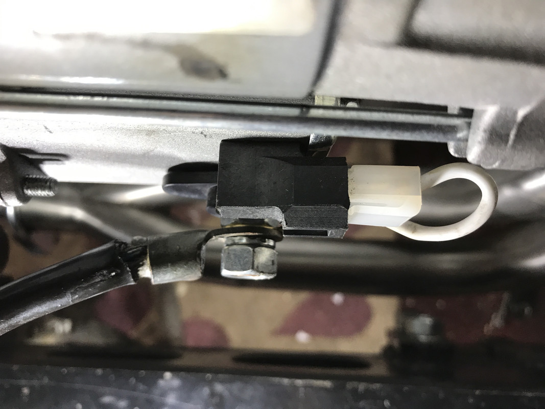

Incidentally here is a close up shot of the main cable
