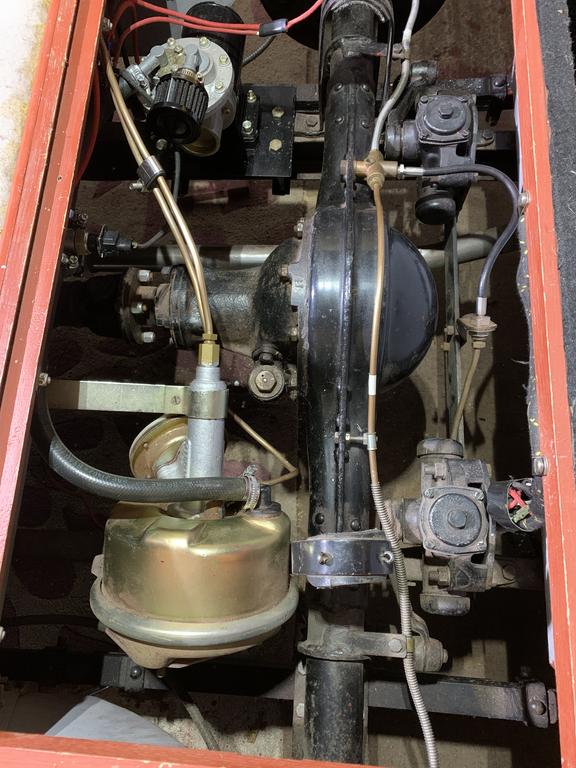

To see if the pump body is "earthed" simply do a continuity test between the case and the black cable, I had considered this but looking at the anti vibration pump mounts in the picture, I'd assumed that even if the case was grounded, the mounts would provide insulation.
If the pump case is "earthed" it would explain why nothing is working! but I would have expected the 10A to have blown. |

AT LAST the vacuum pump is working. One of my customers - who shares my interest in old cars - has investigated my brake servo installation ...and found a couple of things wrong. Apart from my wiring he has identified the electronic timer relay as being part of the problem. This is fitted to prevent "short cycling" and it is polarity sensitive.
With an ordinary relay fitted the vacuum pump sprang into life with the pressure switch working as it should. However the electronic timer relay really should be fitted ... but that requires the pressure switch to be isolated and not be positively earthed as I had it. I have therefore mounted the body of the switch on a swatch of bakelite insulating board; the board is then securely mounted to the body. The switch should now be isolated.
