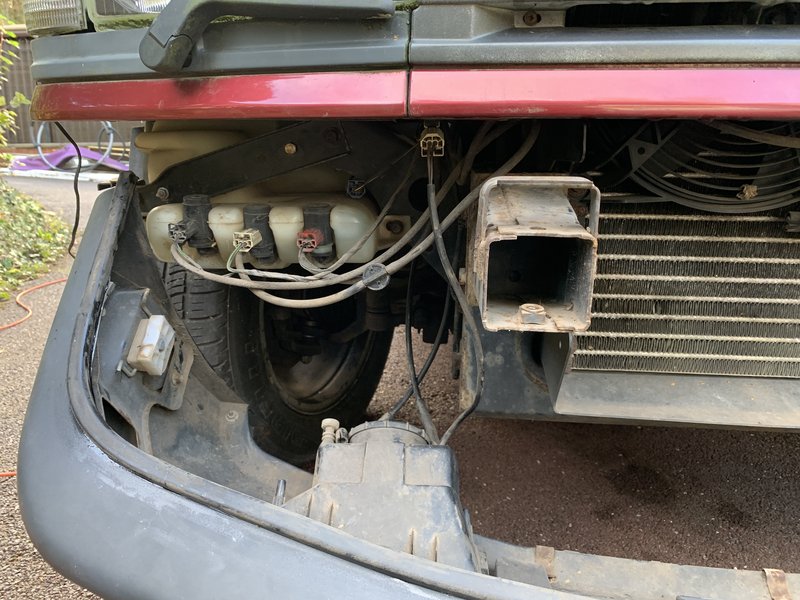

PostPosted: Tue Oct 21, 2025 4:09 pm    Post subject: Reply with quote
A quick update. I have checked that the nozzles are clear and they seem to be.
The bumper removal - contrary to my fears - couldn't have been easier. There were just two bolts which came out easily and the ends slid into plastic retainers on either side. It has obviously been of before and gave me good access to the three washer pumps in the base of the reservoir.
Unfortunately the battery went flat again before I could operate the switch to determine which of the three pumps on the bottom of the reservoir feeds the windscreen washers. I am also unable find a wiring diagram for the car so I can't establish which is which by the wiring colours.
I am thinking of disconnecting the rubber hose and seeing if the relevant pump is working. If it is, the next suspect is the non return valve.
PostPosted: Tue Oct 21, 2025 5:23 pm    Post subject: Reply with quote
As you look at it the right hand pump operates the windscreen washers. In fact the pump is fine. The problem is a non return valve. Of course, it is difficult to get at but perseverance pays and a new one will be sourced.
