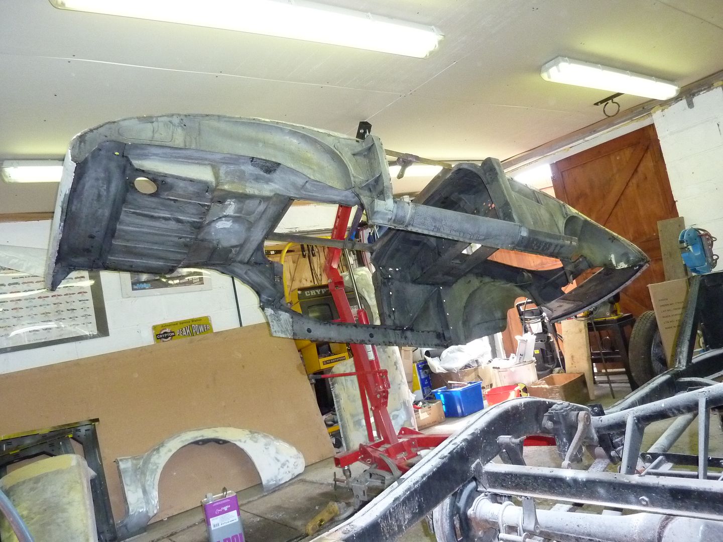

I did my MGA as a body off restoration. Disadvantage is time space, and the possibility of the body flexing or distorting, so I replaced the sills when the body was still on the chassis and as it was a roadster made a frame out of angle iron that held the top of the body together, before I lifted the body off.
Advantages are that you can restore to a factory spec, many jobs are easier because of the better access available with the body off. Painting especially as the body in most cases would have been painted separately to the chassis.
