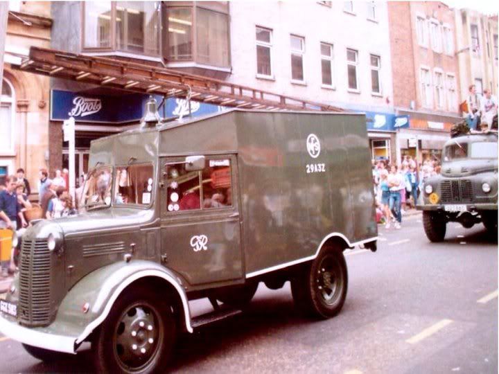

I brush painted my K2. Lot's & Lot's of prep work first though. Fillers Primer and undercoats all rubbed down between coats, and using Valsper Trade Paints. And lot's of masking tape. Using a very soft 3" brush and choosing you areas and work very quickly gently laying the paint off. Then more elbow grease with really fine Wet & Dry. And more elbow grease with T Cut. Then more elbow grease with polish. At my first show at the North East Military Club in Durham, i was told by some ex NFS fella, that should be painted grey not green. I suppose it did help as i was a time served Decorator.
(I used Valspar Paint not Brolac)
