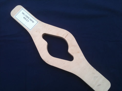

I could always make one of these, I suppose?...
I purchased one of those for my MGA, IMHO they are not up to the job and wouldn't last many wheel changes, I use a Thor hammer, using the hide side for 95% of tightening, and a final whack with the copper side with a bit of card sandwiched between the spinner and hammer to (try) to protect the spinner chrome, whilst not original, as lowdrag suggests, the dead blow, with lead is probably the better option.

I also bought one of these wooden things but it was not useful at all. Being multiplex the layers separated after only a few hard blows. Maybe if it was made of solid wood it would work.
