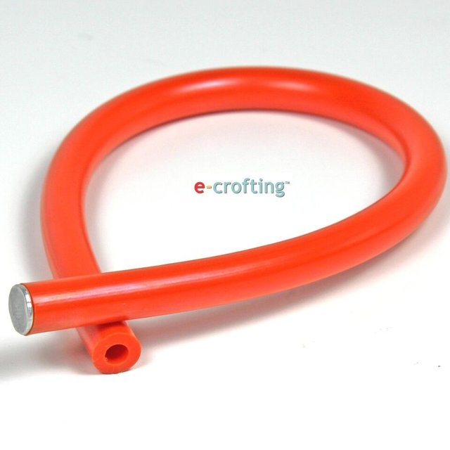

Hello SC. I don't think you need a fancy bleeder set up. All I have ever used is a simple rubber tube with the end blanked off and a slit near the end and a clean glass jar half filled with brake fluid. Make sure the master cylinder is full.
Starting with the wheel furthest from the master cylinder, fit the tube on the bleed nipple and the other end in the brake fluid. Crack open the bleed nipple and depress the brake pedal a few of times. When bubbles stop appearing in the jar tighten up the bleed nipple and go onto the next one. Make sure the master cylinder is kept topped up.
You can speed things up with a helper depressing the brake pedal but I usually do it by myself.
Hope this helps.
