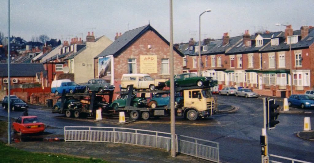

Sorry for the poor photo, its the only one I can find on the computer. Its when I moved house 2 years ago and it worked out cheaper to hire the car transporter than to take them all one by one....
[img] [/img]
It does however show the problem I was having with the side windows, which was rust on the body side due to the alluminium window frame not sealing to the body I'd already took the side you can see out, and treated and resprayed it, which is why it was a different shade around there. The door was in primer too. I've since painted the whole vehicle so its all harvest gold, but had an odd paint reaction on the bonnet top and top of the front wings, so that needs doing again...

That's an excellent picture they are all morris's inc pick-up black at the bottom of transporter?
not sure our fleet would fit on there
mini
mini pick-up
3 x commer pb's
austin a 60
Tina savage replica
2x riley 1.5's
umm best not move house any time soon
you must post some more pic's.....
ps what was the lorry ? |

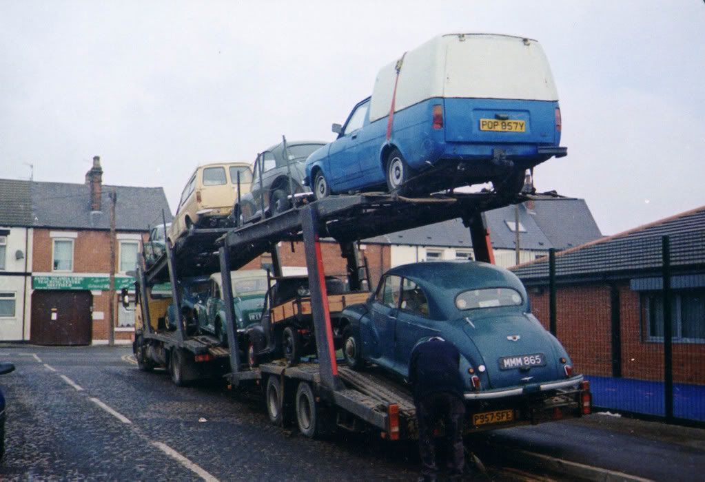

The problem with the car transporter was that all the vehicles had to drive on under there own power. It was a bit of a struggle to find 8 runners... The lowlight Minor on the back end barely managed to drag itself on, and the blue one on the lower deck didn't have any brakes either! The real hopeless cases I had to tow down myself on a trailer behind the Land Rover. These included the Morris J type, the swb Series 1 Land Rover and a load more really sad Minors.
On the top deck, the green Marina had a knackered clutch and had to take a long run up to get enough momentum to get that far! The grey Minor is a friends car that I had in for welding at the time (should have seen his face when I showed him that pic! ) and the GRP top on the Marina pickup had a ratchet strap round it to make sure it stayed on... The Green Marina and the black minor pickup have now moved on. Still got the rest though.
Lorry was a Foden btw. From a local (well local to here now) haulage company in Leominster. Still see it about now and again. We got a lot of funny looks on the journey from Sheffield to Worcestershire
Yeah, I don't intend moving again. There was also the 17 ton flat bed with hiab for the workshop equipment, and the 7.5 ton self drive box van for all the spares and sundry items. Then a Mercedes Sprinter a couple of weeks later for the final 'sweeping up'. Oh what fun  |
