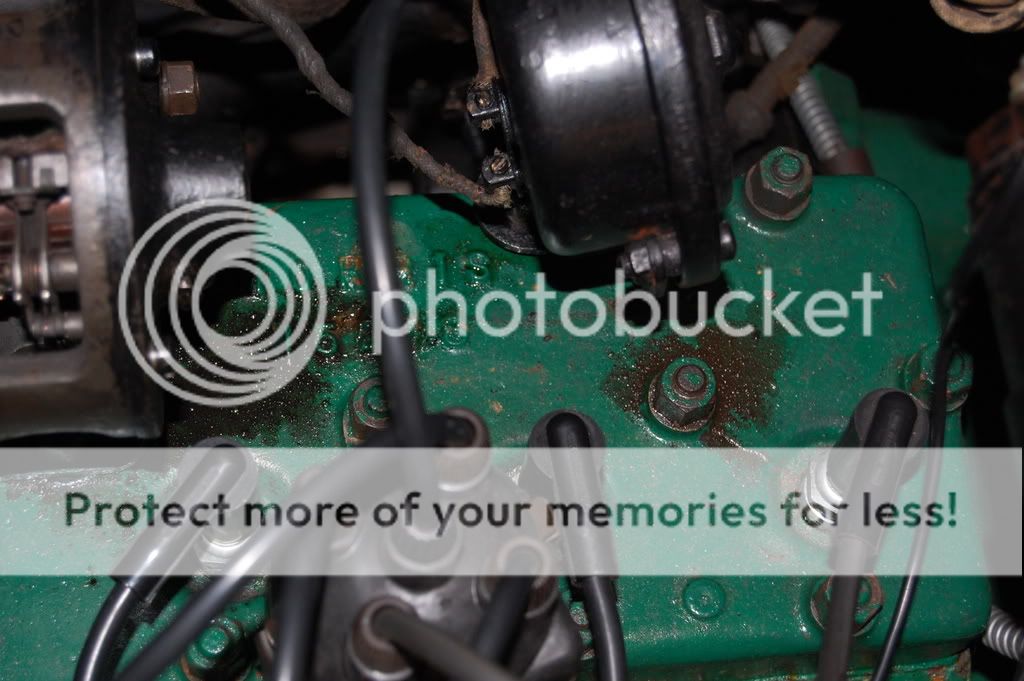

PostPosted: Wed Feb 04, 2009 11:21 pm    Post subject: Reply with quote
OK where is the oil coming from? It is creeping up the studs that hold the head on. I suspect something similar is happening with bros Austin. Side valve engines are all fairly alike. If yours is finding it's way into the water there may be a problem with the head gasket. I think it would be worth lifting the head, sealing the studs and inspecting the surfaces etc. Good luck. Let us know how you get on. We love photos.

PostPosted: Sun Feb 08, 2009 8:56 pm    Post subject: Reply with quote
Thanks for that,just shows what can happen when castings get old.I dont have any still photos of my brothers car,only video.I've spoken to him and explained your photo,he is open to all thoughts and said he will order a new head gasket - these come from New Zealand so may take a while.He has promised to make sure its running OK for the rally starting April 10th, as I'm just about to book my airline tickets,cheers Jon.

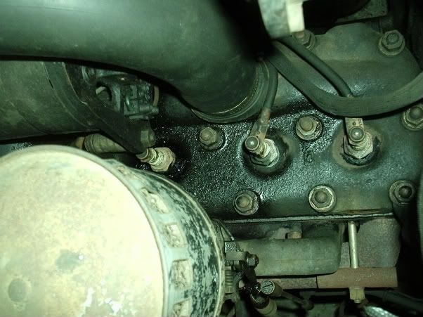

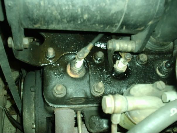

PostPosted: Sun Feb 08, 2009 11:20 pm    Post subject: Reply with quote
Hi the oil seeps up through the studs on my Austin 10/4 and does the same on my mates 10/4 as well. It's been doing it for last twenty odd years in my case. My mate told me it's something to do with the type of oil used.
It can only come from the cylinder lubricant as the studs should not be connected to any oil way. Sometimes it even blows past the plug threads.
It's never caused us a problem and there is always evidence of a tiny amount of oil getting into the coolant. We ignore it.
I am assuming the six cylinder engine to be similar to the ten, but with a couple of extra pots.
Using that blue gasket seal (I forget its name) may well cure it and reduce the chances of the gasket blowing. Modern pattern gaskets are not as good as the originals and it may well be a contributing factor.
ps. You'll notice it only happens on the studs between two combustion chambers.
Don.

PostPosted: Mon Feb 09, 2009 11:31 am    Post subject: Reply with quote
Just been out and taken some pictures. The engine has seepage through the studs and plugs that is pretty typical of the last 24 years and 30 odd thousand miles.
