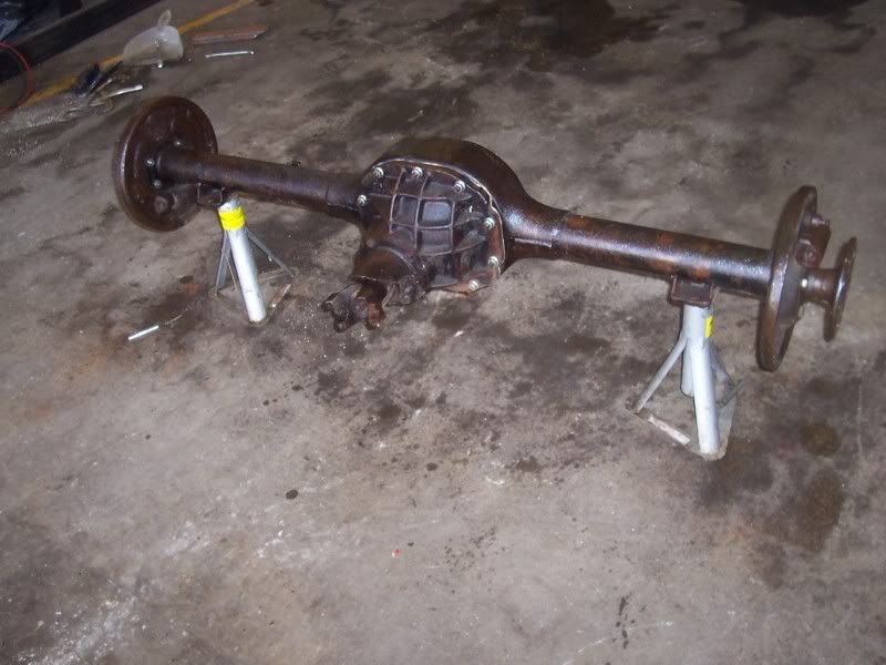

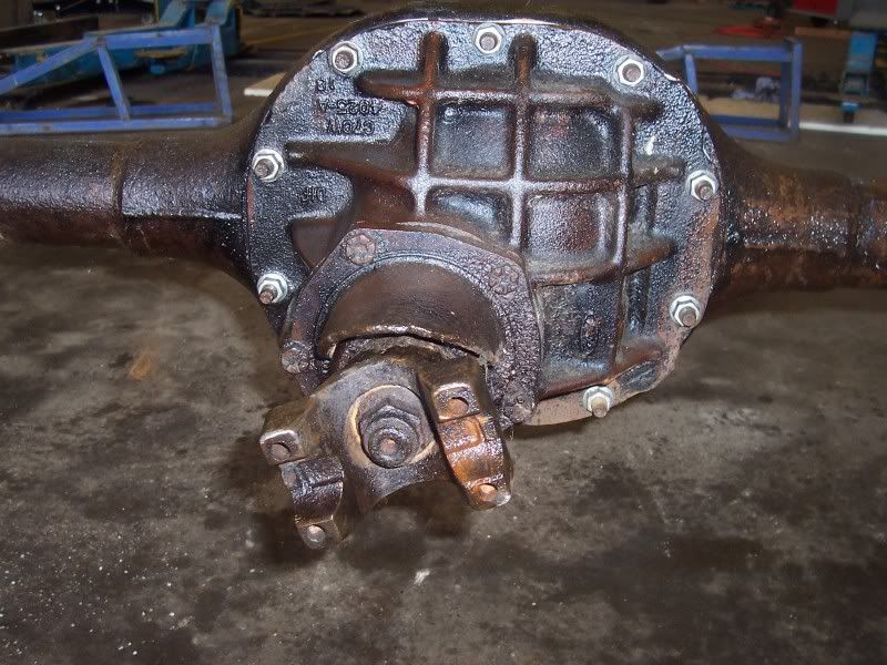

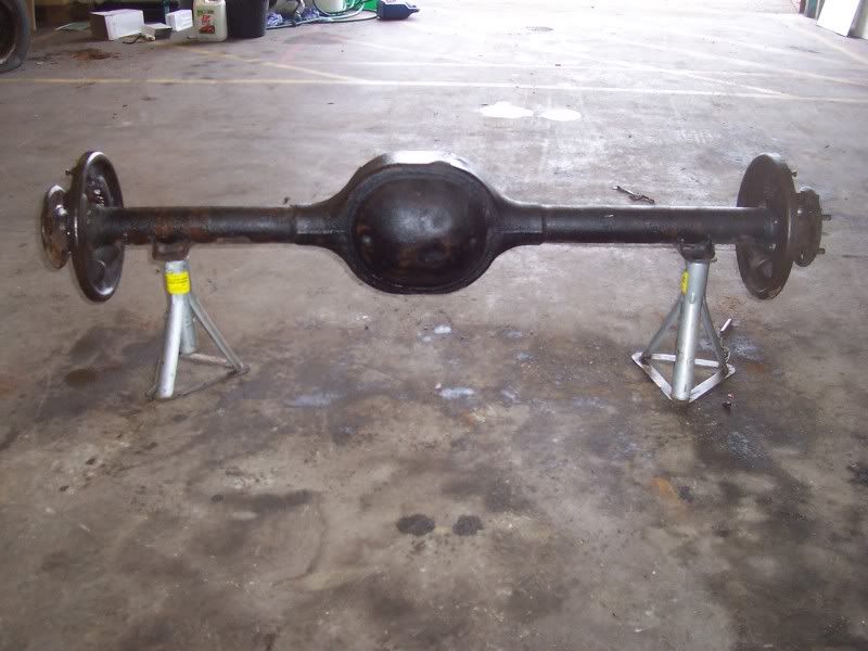

ive got this rear axle which has 11inch brake backplates so 10 inch drum, it measures 1430mm between hub flanges (56.2"), the UJ yoke is 80m with 28mm caps, the axle is marked c70w 4025-A 18, ive done a few googles but its the 18 bit that doesnt come up

| Ford 8 inch probably from a 1971-77 Maverick. |

This type rear end is referred to as an 8 or 9 inch which is the size of the ring gear as 47Jag related.
Your casting numbers indicate that it's an 8 inch and your measurements would put it in a Ford Maverick.
There should be a tin tag bolted to the center housing but I don't see it in your photos. Not unusual as they get lost or tossed. The tag would have more letters/numbers and would give the axle ratio. |
