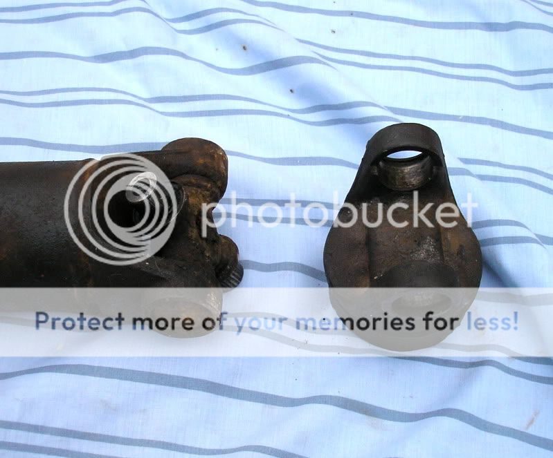

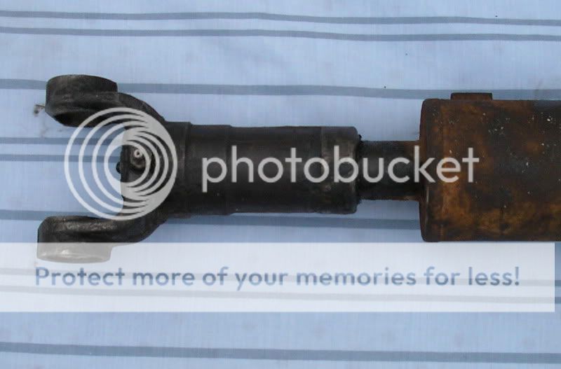

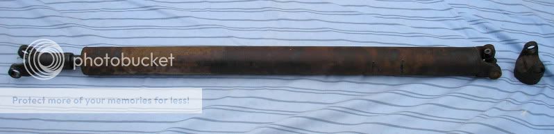

After last year driving around with a top speed of 45 in my Chevy Pickup I've fitted a 1960 diff (straight 10 bolt swap) which should give me a 50mph cruising speed this year Smile
The only thing left to do is get the prop shaft remade with a 60's yoke at one end, the original at the other, and a new straight shaft in between with another 1/4 inch in length.
I have found a reasonably local prop-shaft maker in Bonnybridge but wondered if anyone had any other suppliers and any ballpark costs this could cost me.

Thanks, but the overall prop is now a bit short - and always had a bit of a buckle in it so a new one is needed.

Thanks Keith, that's the problem I have just now as the prop has a run out of 9mm when the recomendation is under 1 Very Happy
I've contacted http://www.driveshaftuk.com/ and they estimate £150 delivered which sounds reasonable to me.
