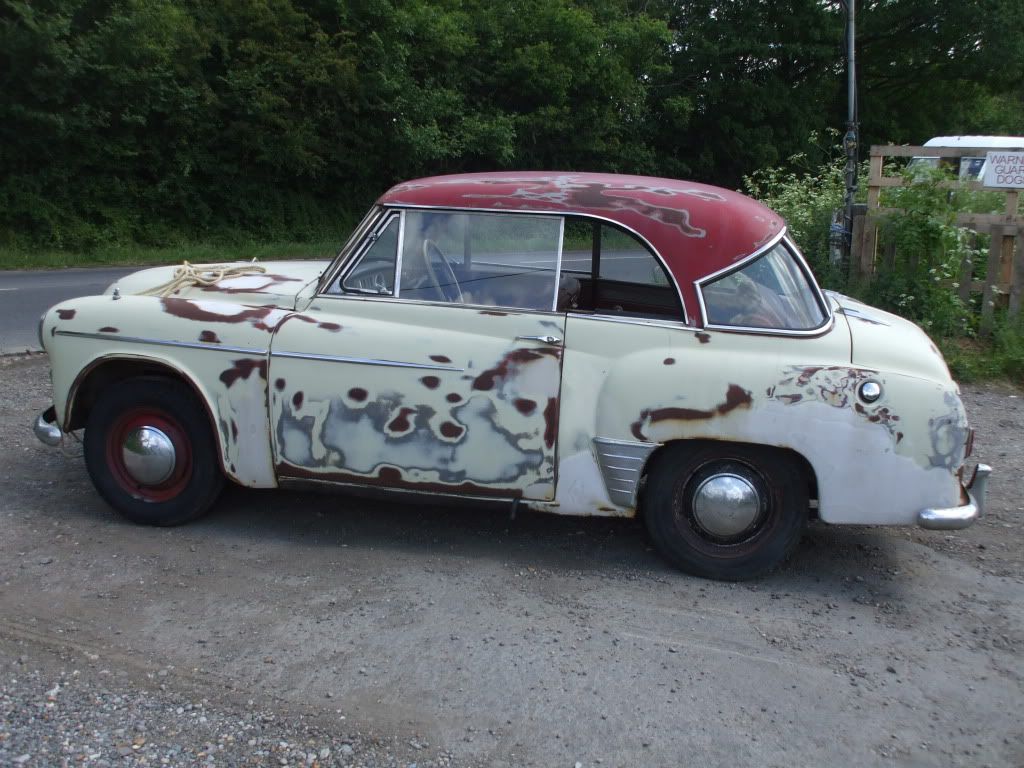

This was going to the crusher.A contractor had been called in to clear premises behind a church in London.Two cars were saved from their FATE!!!
I secured this 5 minutes after it went on the market,PHEW!!
Ok it will not set any speed records,but when did you last see one Question
Since getting it home I have been busy working on it this weekend.
The underside is like a lorry chassis Exclamation Exclamation
I changed the fluids,cleaned out the fuel system and cleaned up the ignition system.
With a new battery connected she arose from her long slumber and settled into a nice tick over.
Very Happy
Excellent oil pressure and no noises. Very Happy
Amazingly the clutch was not stuck and the car moved under its own steam.
All the electical items and ancillaries work.
Before being laid up new brakes and an exhaust were fitted.
The brake system was bled through and the brakes adjusted.
I will MOT it as it is then attend to the bodywork. Very Happy

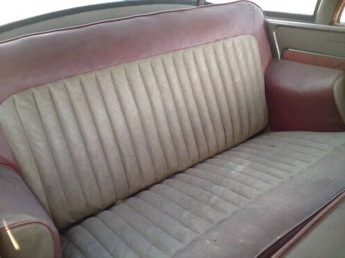

[img][/img]
The interior is all complete and in very good order,this will clean up well.
Only the fitment of new underlay and carpets to carry out.

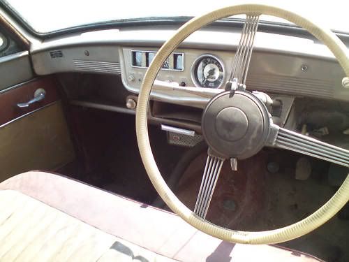

p.s. I think there is something a bit odd about the steering wheel/manette in your car. It appears to have a second switch at 6 o' clock and doesn't have
the Rootes symbol in the horn button. I think it should be more like the ones
shown here. (although they appear to have some wrong colours in places.)
