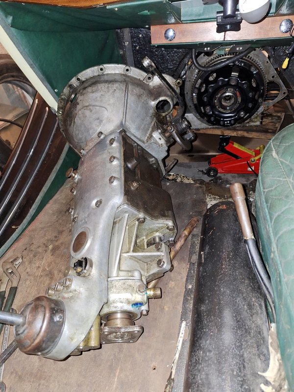

Over the last couple of days I have been removing and refitting the gearbox to let me replace the centre plate and cover. It's a toss-up whether it's easier to take the engine out or take the gearbox out.
I really don't like taking the bonnet off and on single handed so the gearbox was my decision. Apart from the need to remove floorboards and two exhaust systems it also needs the propshaft disconnect at both ends.
I managed to remove the gearbox yesterday and today replaced the clutch and got the gearbox back in.

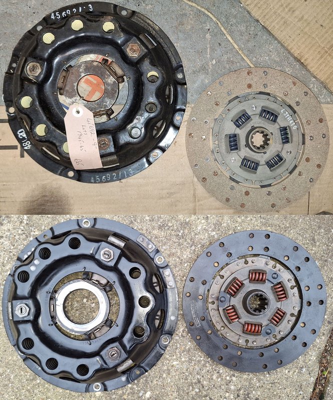

This could be a factor. My measurements of the clutch lining thickness differ from the actual specification that defines the individual lining thickness rather than the overall thickness.
The individual lining thickness spec is 0.145" to 0.155". This is more difficult to measure when the two layers are sandwiched together. My failed plate has thicknesses close to 0.145".
Here are the new and failed plates and covers without any wiping or cleaning. There may be a slight oiliness but certainly not a lot. Another factor may be the spring characteristics. The correct springs are cream colour whereas there is no obvious colour on the springs in the failed cover.
PostPosted: Sat Nov 09, 2024 11:44 am    Post subject: Reply with quote
I would have said the springs are the problem. If it was the clutch lining I guess you would have smelt it burning.?
Having said that it does look to have an oily sheen look about it.

I agree re-the springs.
I wonder if you could insert two pence pieces under the springs, or some of the springs, to increase their rate a bit?
