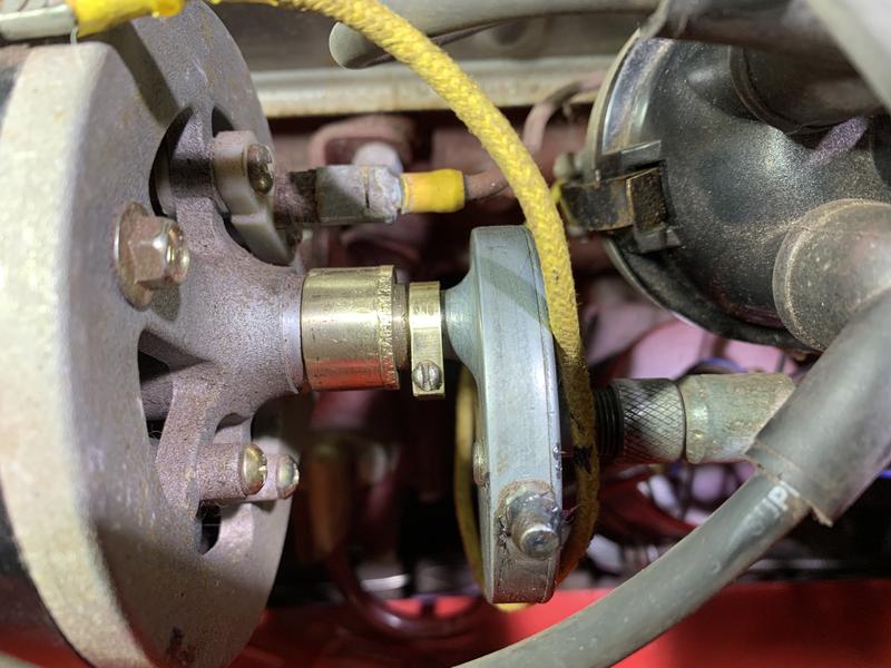

The problem seems to be with the drive. There is a small gearbox fitted to the end of the dynamater ..and it growls when I touch it.! However, the cable turns if I twist the gearbox input shaft so I can only assume it is the drive coupling inside the dynamater . The male end where it protrudes from the front of the gearbox looks very home made. There is a key on a square shaft. It was working O.K. before so what has happened ?
Here is a shot of the little gearbox...
Posted: Mon Dec 29, 2025 2:34 pm Post subject: |
I'm pretty sure repro gearbox's are available, I looked at one for a completely different project , but the ratio's were not correct.
If it is faulty you have nothing to loose by opening up, it can only have a couple of gears that you may be able to fix. |

Hi Dave. The cable turns if I rotate the input shaft by hand. If connected up, with the engine running, the instrument end of the cable turns.. I have opened up the reduction gearbox and it all looks O.K. in there. The cable, it seems, cannot operate the dial.
If the instrument is faulty then I will be rather annoyed as I had it professionally restored (along with the other instruments) by John Marks (Vintage Restorations) at not inconsiderable cost.
Then again I remember reading years ago about what could happen if a small 'U' shaped washer is left off each end of the cable. It prevents the inner from retracting into the housing and so not engaging. I don't think my cable has these pieces...so that is something I can investigate.
