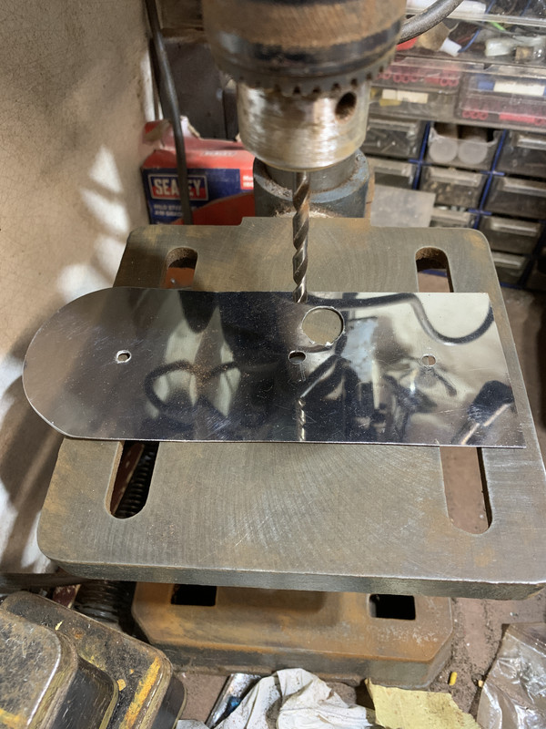

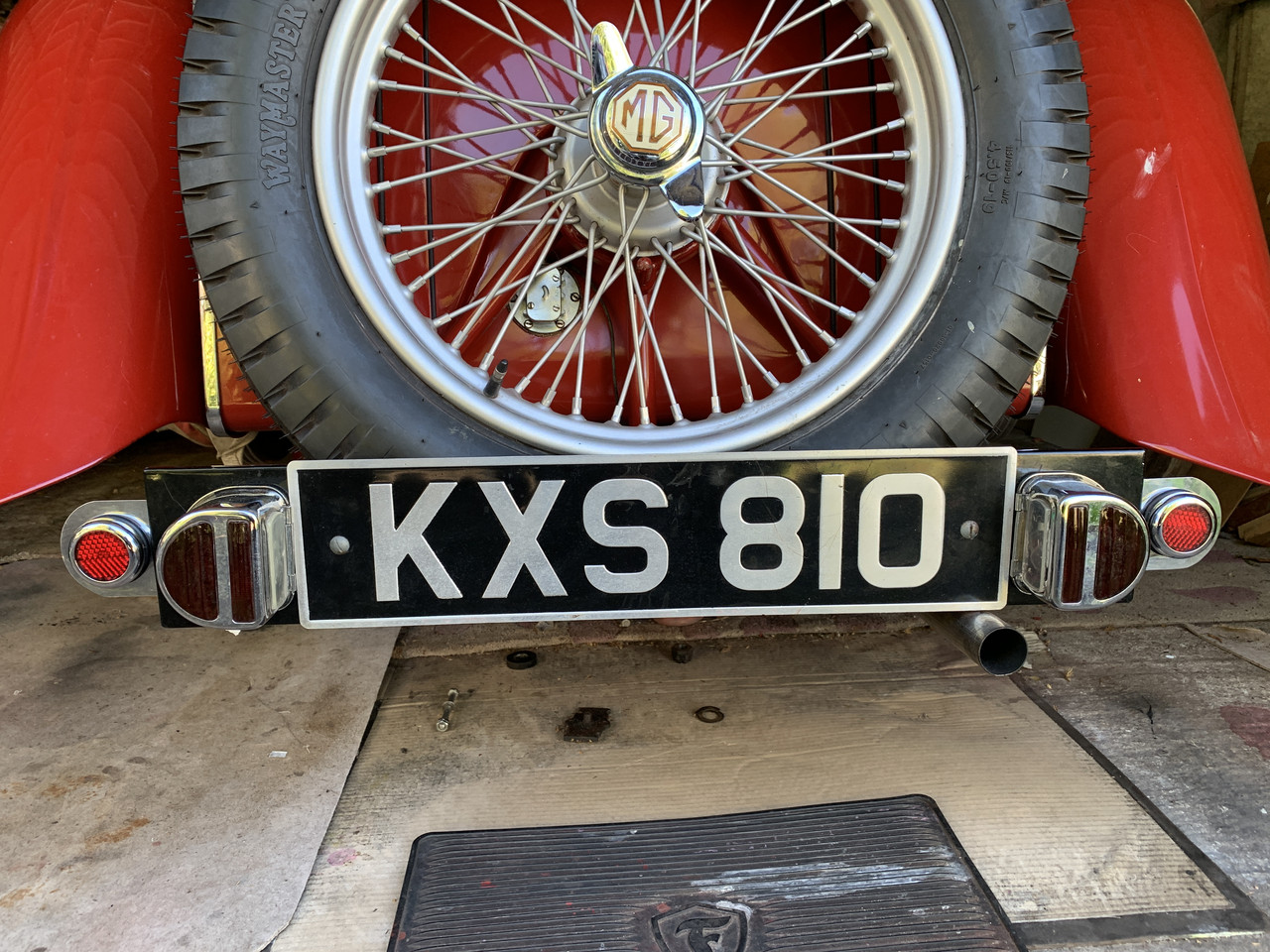

I finally settled on a place for my new reflectors. Either side of the number plate was within the recommended parameters and didn't seem too out of place. At first I was unsure about how to mount them but I eventually decided on some polished stainless steel plate; cut down to a reasonable size with each of the plates shaped at their ends to match the profile of the reflectors and D lamps. They are conveniently held in place by the two D lamp screws.
Further openings were needed to allow the grommeted stop and side light wires to pass through.
I am happy enough with the result and - as always - the modification can be easily reversed if required.

Very nice and correct "in period" with the car. _________________ http://www.showcars.dk/ |

Ray, that is a great result on all levels, firstly one wouldnt even look twice at it because it blends in so naturally, secondly as you indicate, if ever required, it is easily removable without any damage to rectify, great job  |

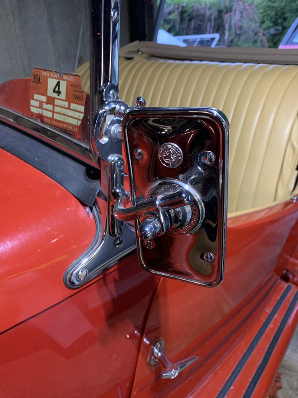

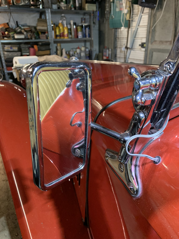

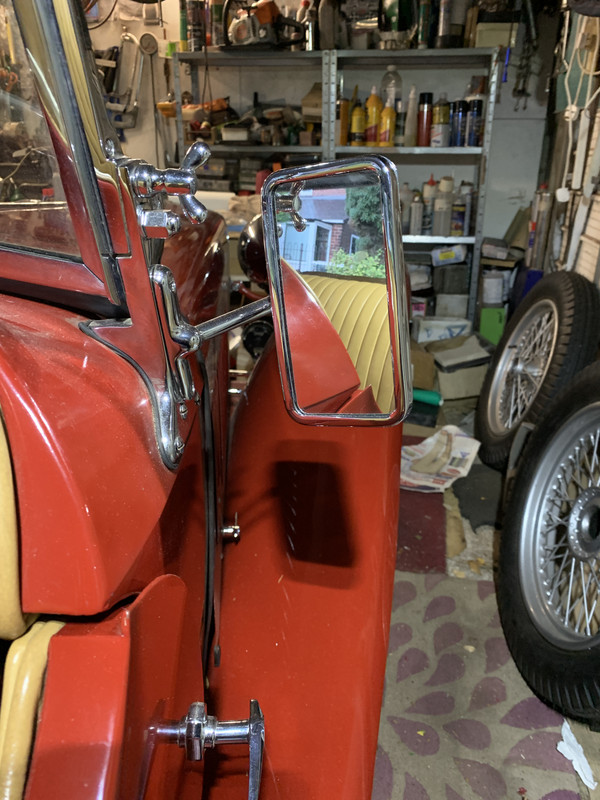

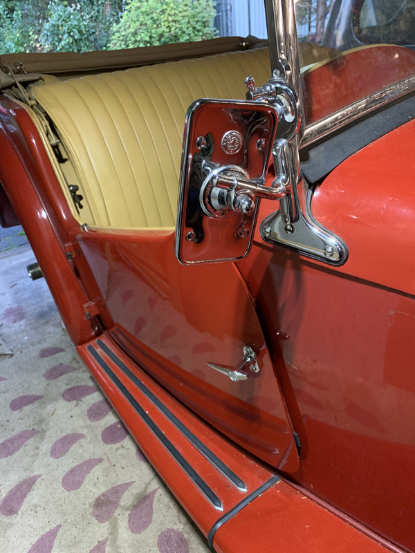

I have also been having fun with rear view mirrors. I did the driver's side a a while ago and felt that having a near side mirror would help balance the look of the car while helping with the driving experience.
The driver's side was easy as threaded holes in the windscreen stanchions were already there. The near side, however, was a different kettle of fish. The correct mirror head and arm was available but I had to drill and tap two threads into the chromed windscreen stanchion; not a job for the faint hearted when a slip could prove not just expensive but - given the amount of work involved with fitting the folding screen - frustrating as well.
