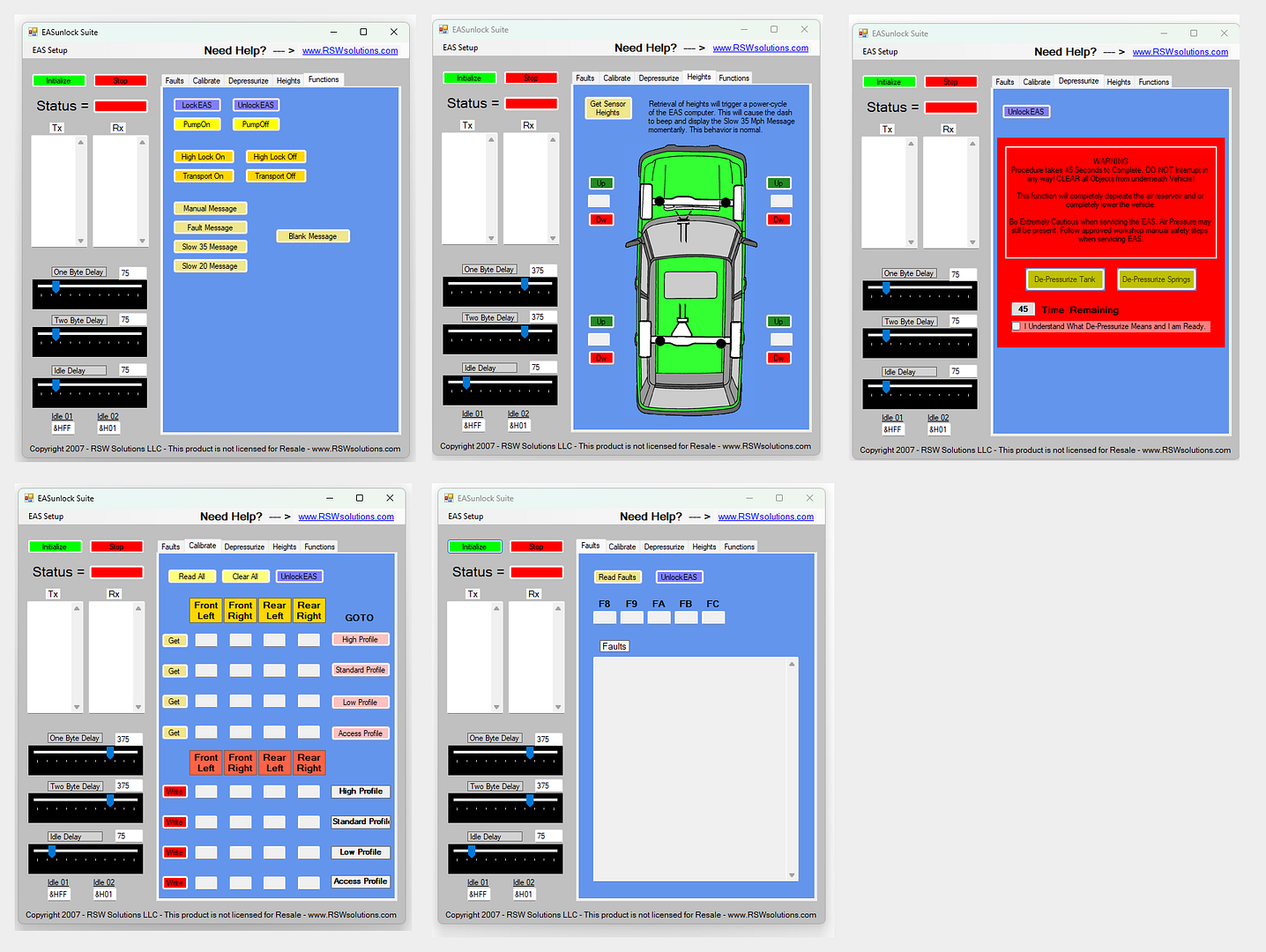

I just tried it!
Good news is that it is virus free, so looks like a genuine bit of useful openware.
You get the following menus, these will probably make more sense to you being familiar with the P38 EAS.

IT all sounds a bit too good to be true ...but if I can override the message it will be a real game changer.
AS it happens, Jean has managed to dig out an old DELL computer (with windows) and it is presently on charge. If it still works O.K. then the next step is to find or buy a "serial" cable from somewhere. Then we can download the software and see if it will talk to the EAS.
